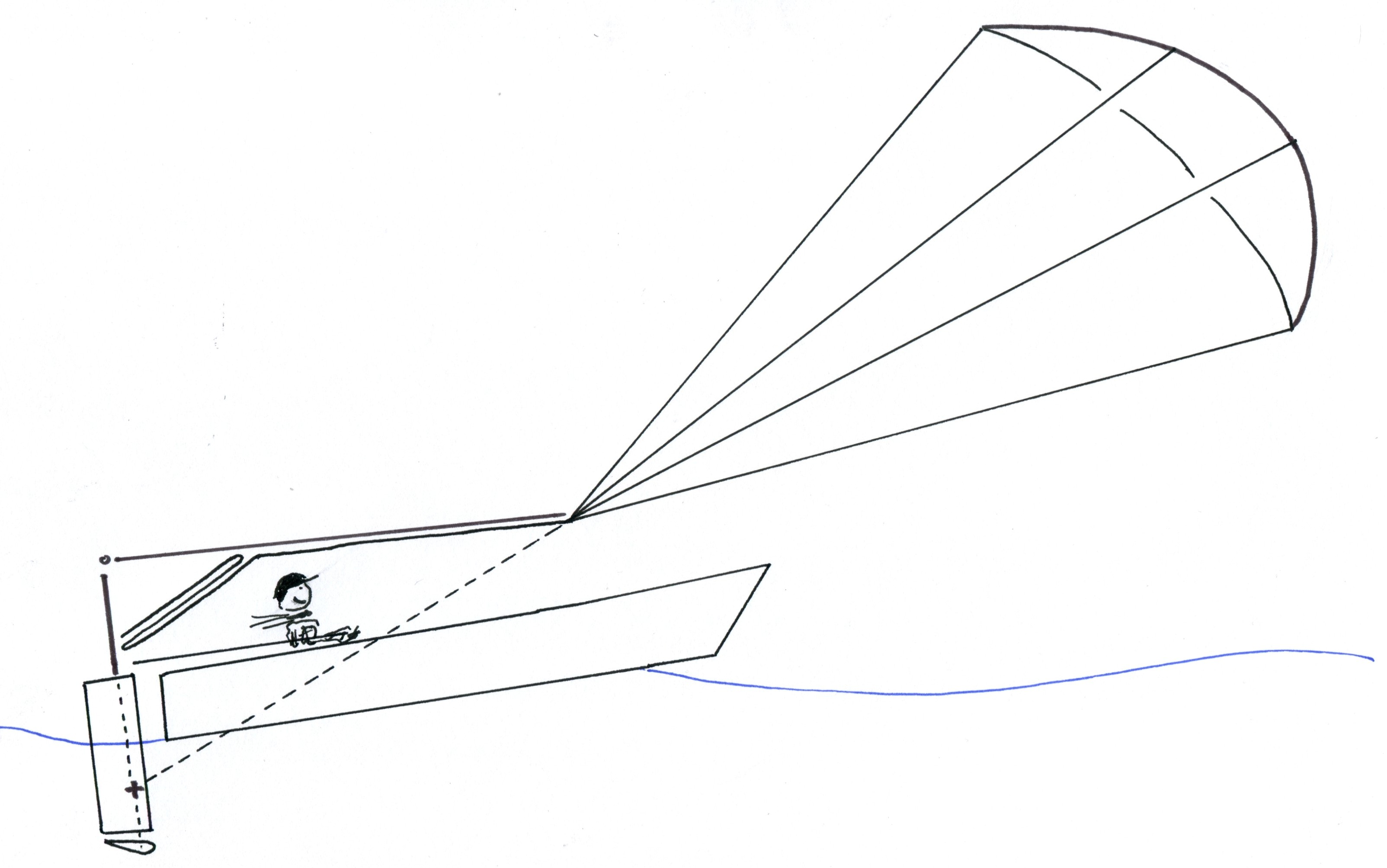

Post by Bruce M »
Thanks for the tip. Hopefully the image will now come through O.K.
(358.07 KiB) Downloaded 1476 times
The sketch illustrates how the rig is arranged so that the drive force from the kite acts directly through the centre of lateral resistance ... so the boat does not heel. As the kite moves the boom follows the kite with the result that the drive force continues to work through the centre of lateral resistance - that's been tested several times and works well.
The sketch also illustrates the rig mounted above a combined 'keel-rudder' system which balances the sideways component of the wind load ... so no leeway. That has also been tested and proved to work.
Now I need to get tide, wind, safety boat, crew and myself to the beach at the same time for the next set of tests.
Bruce
