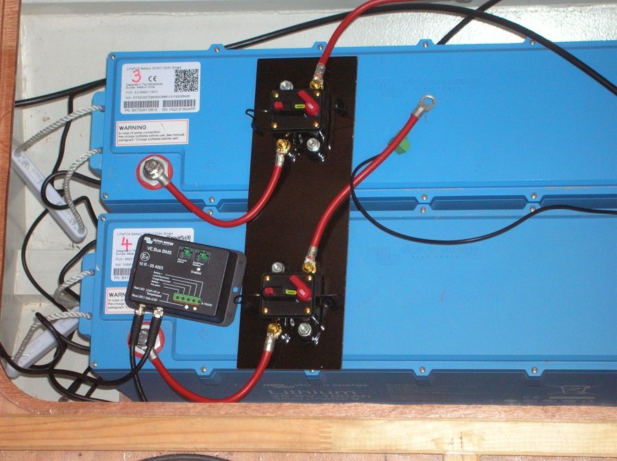

I'll use about 4 MPPT regulators (Victron), splitting the panels in groups. This is to achieve a better efficiency, as the cabin top is slightly curved, there is a different irradiation at starbord and port most of the time. As the MPPT is based on the average states of the panels, it is better to split.AlexQ23 wrote: ↑Sat Apr 17, 2021 10:59 pm[...]

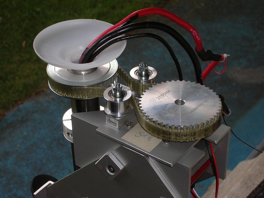

I already ordered some toothed belt discs with additional machining to fit on the shafts of the trolling motors. Clearly I'm not able to operate the two outboards with their tillers, as the helm is at cabin front and the motors 4 to 5 meters behind. So I have to do it with other means. For normal course it will be done with servo motors which turn the motor shafts, as a backup there will be a cable steering.AlexQ23 wrote: ↑Sat Apr 17, 2021 10:59 pm[...]

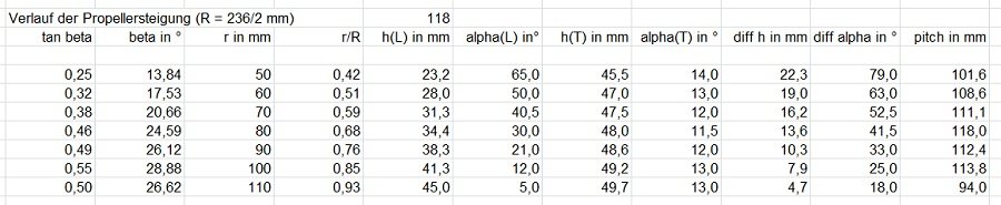

I did some measurements of the pitch along the propeller blade. Yes, the pitch is changing. I attach a table with this data.AlexQ23 wrote: ↑Fri Apr 29, 2022 1:31 pm[...]
Another remark concerning the pitch of 117 mm of your actual screw: with btrolling motors, due to the fact that the propeller is behind the motor and is working at various speed this could not be a pitch constant propeller. So it will be a good idea to check it by your self all along the blade lenght.

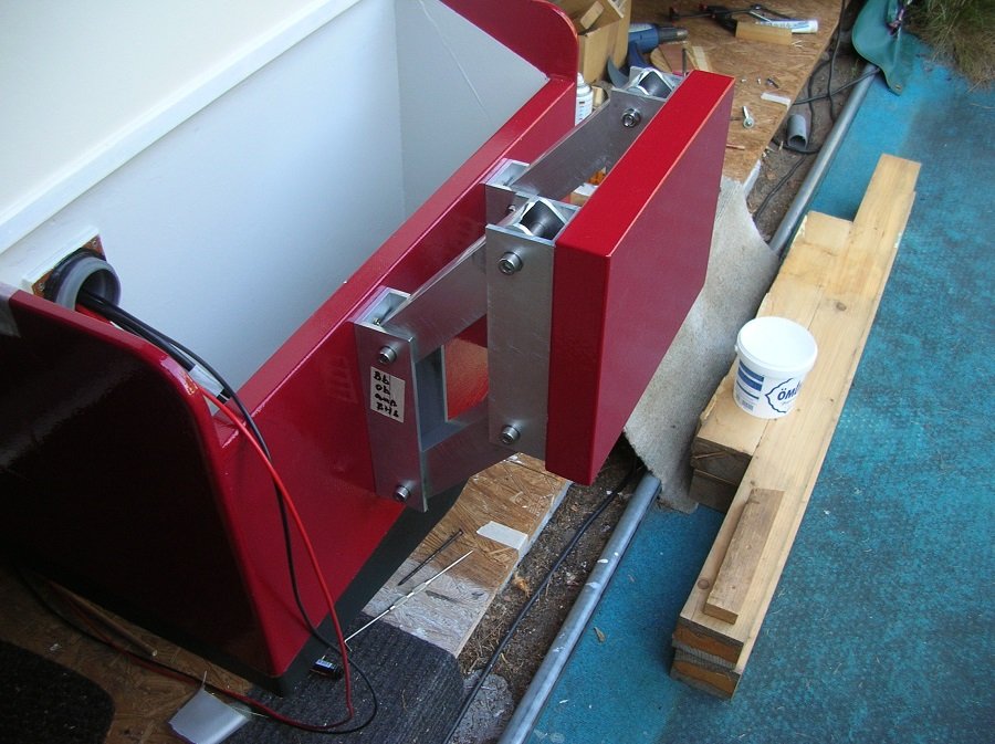

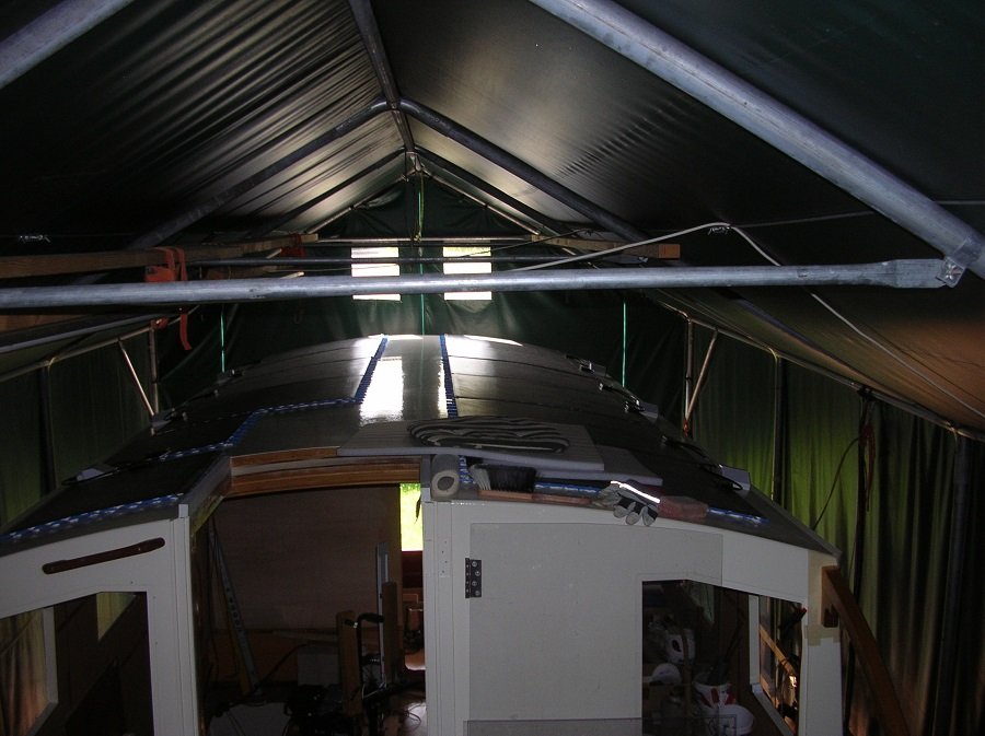

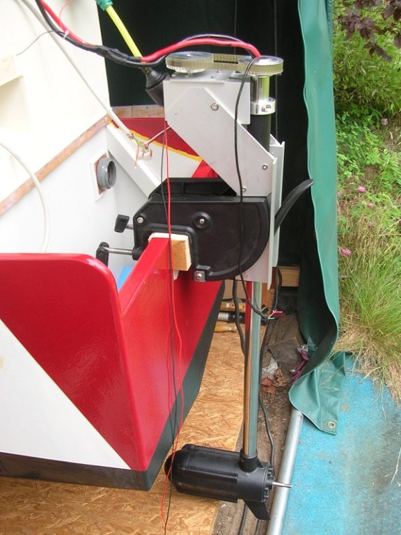

The solar electric outfit and motor mount (with steering) is partly done. More than half of it hopefully.
TheoSchmidt
- Quiet member
- Posts: 12
- Joined: Sun Mar 13, 2022 8:04 am
Re: solar electric propulsion of a power kat, 6.3 m
Great, Heimfried! Is this now one of two catamaran hulls or have you changed to a monohull? Or is it a very narrow cat?
In the picture above is just one transom of the two demi hulls.
