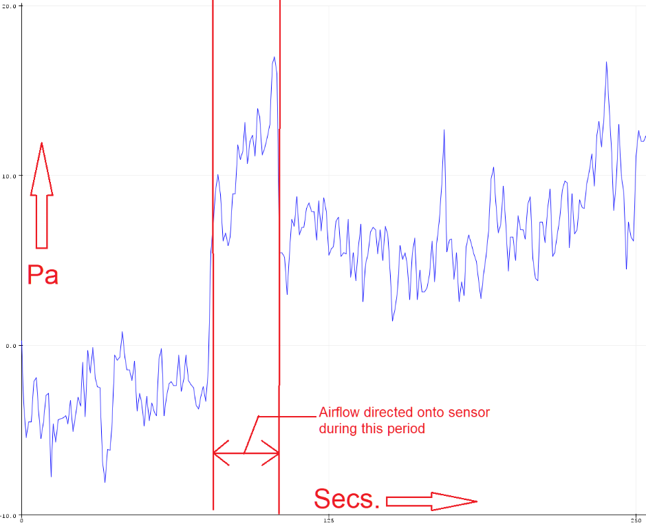

Meanwhile, I wondered about commercially available pressure sensors for low pressures, these are generally piezo resitive sensors. I happen to have such a sensor, an MPL 3115A2, built into a small 'breakout board' from Adafruit Inc. I think one of the main applications for such devices is for use as an altimeter to stabilise the height of drones. I have had this device lying around for some time and this afternoon I got round to hooking it up to an Arduino and logging the readings from it. I would assume that sail pressure measurements would be carried out in fairly light winds, at least to begin with, so the requirement would be to measure pressures up to a few tens of Pascals with a resolution of 1Pa or better. I have to say that from my quick trial I dont think the MPL 3115A2 is good enough for this. I attach a graph (see end of this post) straight from the 'Serial Plotter' facility in the Arduino IDE, this graph showing the readings taken over a few minutes, each reading being relative to a mean pressure determined from a series of initial readings. For part of the graph I blew cool air from a hairdryer (with the heating element off) onto the sensor to simulate a gentle breeze. The sensor did respond to this but the response was hardly more than the variation and drift that occurred between readings with the sensor sitting in still air on a desk indoors.
(89.84 KiB) Not downloaded yet
