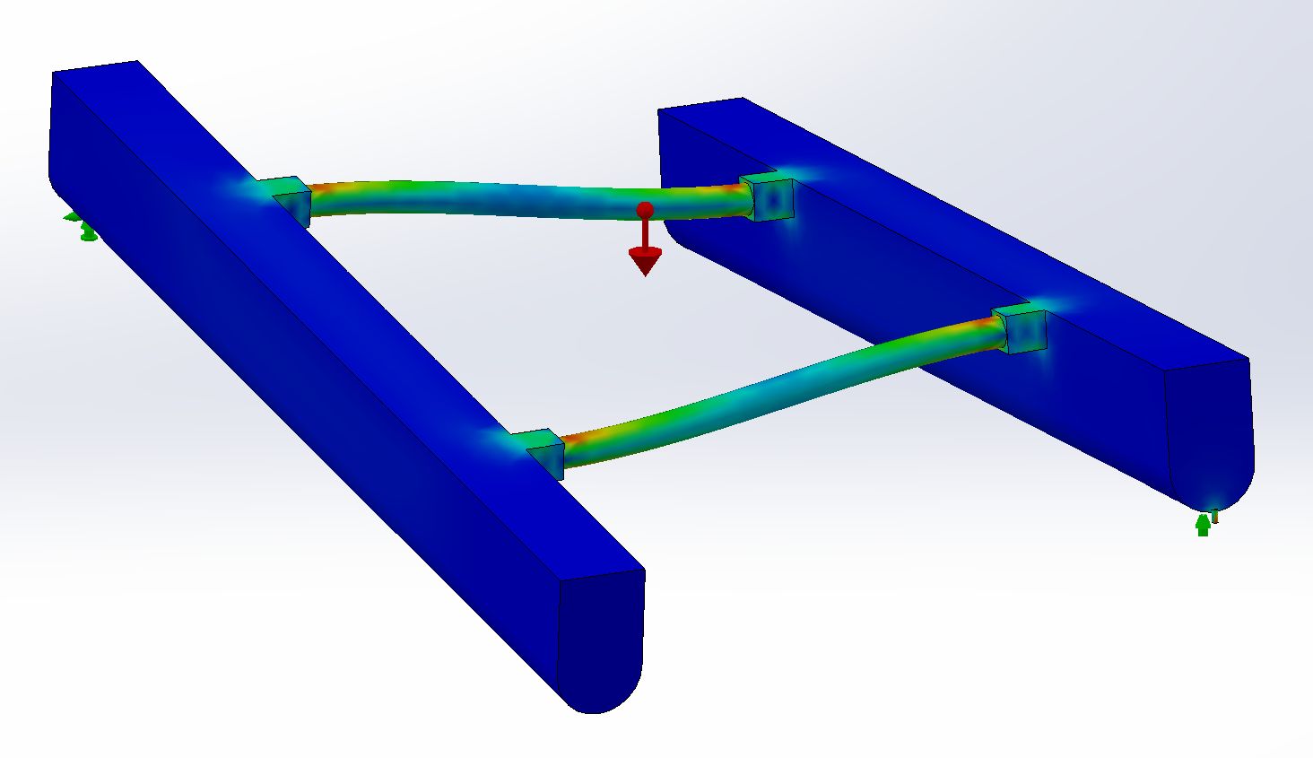

Not in either individual beam. And my understanding was that the torsional strength of individual beams makes a negligible contribution to the torsional stiffness of the whole structure.John Perry wrote:Robert: Quoting part of a sentence from you message, I think the above is a misconception. Considering two hulls joined by two cross beams, it is true that as the craft as a whole is twisted (i.e. one bow and an opposite hull stern rising relative to the other bow and stern) then each individual beam is subject to torsion producing shear stress in the cross beams that can be calculated from the second moment of area of the cross beam section and the angle of twist per unit length of beam. However, no additional torsion results from the fore and aft spacing between the two beams.and partly from the moment of inertia that comes from the distance between beams.
My memory of what I read also is that if the hulls of a catamaran can be treated as rigid, then the two beams can be thought of like the two sides of a single I beam. I don't know whether that works out the same as your account when quantified. The two accounts have in common that the structure is stiffer in twist the more the two beams are separated.
If the my interpretation of what I read is valid, then the two beams getting closer together when hulls slew should make the whole structure less resistant to twisting. In your account, what happens when supporting the whole boat by one bow and one stern when the beams are at 90 degrees to the longitudinal axis versus some other angle? Do the beams or any other part of the structure need to be stronger to deal with that?
- Posts: 82
Re: Request for collaboration
Robert, I guess that what you meant to say is the the torsional strength of individual beams makes a negligible contribution to the torsional STRENGTH of the whole structure. Strength and stiffness are different properties! (and both are important in boat designing)Robert Biegler wrote: Not in either individual beam. And my understanding was that the torsional strength of individual beams makes a negligible contribution to the torsional stiffness of the whole structure.
But, leaving that quibbling point aside, I do agree with you - both the strength and stiffness of the whole structure under twisting loads are more dependent on the bending properties of the cross beams than on the torsional properties of the cross beams. However, I am not sure I would go as far as to say that the torsion has negligible effect, I think that I would want to include both both bending and torsional effects in a design calculation, at least until I was sure that I could neglect the torsional effects. Another point is that there have been a few multihulls built with only a single cross beam, for example the Hydropterre trimaran and the trimaran that Peter de Savery had built with the America's cup in mind. For a multihull that has only one cross beam, the torsional strength of the cross beam is obviously critical!
The torsional stiffness of a shaft can be calculated from the second moment of area of the shaft cross section, the torsional modulus of the material and the length of the shaft, the relevant forumlae can be found in any textbook on stress analysis. However, any such text book will also tell you that this method of calculation is based on certain assumptions, one of which is usually quoted as 'plain sections remain plane'. That means that if we consider all the molecules of the shaft that lie on some plane transverse to the axis of the shaft when the shaft is not twisted, those molecules must still lie on a flat plane after the shaft is twisted. It is not correct to treat any normal pair of multihull cross beams as a single member under torsion with a combined second moment of inertia for the two beams together since the bending that occurs along the lengths of each beam when the whole structure is twiste, violates the assumption that plain sections remeain plane.
I have made a quick finite element analysis to illustrate these points. The first picture below shows a simplified catamaran structure - I haven't bothered to give it pointy bows or tapered sterns since the details of hull shape are not relevant for this purpose. If the hull centre-line spacing is taken to be 'L' I have made the overall length of each hull '2L' and the cross beam spacing 'L'. As Robert suggests, I have supported the craft on small supports located right at the bow of one hull and the stern of the opposite hull and I have allowed the weight of the craft to twist the structure - not a purely academic load case, I can somehow imagine that inadequate support for a catamaran during on-shore storage could result in this kind of situation.
As you see from the first picture, each cross beam bends into a slight S shape (the picture exaggerates all distortions to make the distorted shape clearer). The colors indicate the level of the Von Mises stresses, red being high, blue low. Clearly the beams are subject to bending stresses wjth highest stresses being towards the top and bottom of the beams in the regions of the beams where the curvature is greatest. At the midpoints of the beams there is no curvature, these being points of inflexion, so there are no bending stresses at the mid-points of the beams, but note that even at these points the Von Mises streess is a bit higher than it is in the main body of the hulls (where it is very low because I made the hulls solid, so they are very ridgid), this being due to the presense of torsional stress which applies uniformly right along the length of each beam.
The second and third picture shows what would happen with the same support/loading arrangement if this were a 'slewable' cat, as Robert describes, with the hulls totally slewed so that the cross beams lie parallel to the hull centrelines. Two pictures, one for supports at the hull ends that are futhest appart and one for supports at the hull ends that are in proximity. You see how the beams still bend into an 'S' shape, but the points of inflexion no longer lie at the beam midpoints and the bending stresses are higher towards one end of each beam, the highest stresses being greater than for when the hulls are not slewed (as in the first picture) - I hope this answers Robert's question, but if actual stress values are needed a lot more detail of the craft would need to be known.
Note that in the second and third pictures the cross beams are not twisted along their length (since the hulls have not rotated about their long axis) so at this slew angle the cross beams are not subjected to any torsional loading, only bending loading. Note that the stress color at the points of inflexion in the second and third pictures are a darker blue than in the first picture, about the same shade of blue as the hulls, indicating no torsional stress at these points as well as no bending stress.
I suppose I could repeat this analysis for an intermediate slew angle, say 45 degrees - this would show a stress situation intermediate between the the two extreme slew angles, zero degrees (first picture) and 90 degrees (second and third pictures)
BTW, if you are wondering what the red arrow pointing downward in each picture is, that represents the force of gravity directed downwards from the centre of gravity of the whole craft.

Probably. I had assumed that if the structure is designed to impose greater stress on an element, say by closer spacing of the beams, there would be more strain.John Perry wrote:Robert, I guess that what you meant to say is the the torsional strength of individual beams makes a negligible contribution to the torsional STRENGTH of the whole structure. Strength and stiffness are different properties! (and both are important in boat designing)
This is exactly what I had hoped to see. Am I correct in interpreting the larger red areas as representing greater stressed when slewed? Such that a slewing catamaran would need stronger beams?John Perry wrote:The second and third picture shows what would happen with the same support/loading arrangement if this were a 'slewable' cat, as Robert describes, with the hulls totally slewed so that the cross beams lie parallel to the hull centrelines. Two pictures, one for supports at the hull ends that are futhest appart and one for supports at the hull ends that are in proximity. You see how the beams still bend into an 'S' shape, but the points of inflexion no longer lie at the beam midpoints and the bending stresses are higher towards one end of each beam, the highest stresses being greater than for when the hulls are not slewed (as in the first picture) - I hope this answers Robert's question, but if actual stress values are needed a lot more detail of the craft would need to be known.

Hi Robert, Sorry you lost your typing, this reminds me that when writing more than a few words to an internet forum it is best to first enter the text into a separate app then copy and past it to the forum website! I like to use the free Notepad++ app for that kind of thing, I find it much better than a full word processing app when you just want to put text together and are not worried about the layout of the text on a printed page.
Anyway, you asked:
What is actually happening is that the beams are bending rather differently in those two diagrams. For the non-slewed diagram, if we consider each beam individually, one end of the beam is going up and the other end is going down, relative to the middle of the beam, but the topsides of the hulls remain parallel to each other so there is no rotation of the ends of the beam about a horizontal axis transverse to the beam. This means that each beam bends into a symmetrical 'S' curve with the same curvature and the same bending moment at each end of the each beam. Compare this with the second of the two diagrams. Again, relative to the middle of the beam, one end of each beam is going up and the other end is going down and if it were still the case that there were no relative rotations between the beam ends then the bending moments and bending stresses in the beams would be exactly the same as for the first diagram. However, in the case of the second diagram, the longitudinal tilting of the hulls is causing a relative rotation of the beam ends about horizontal axis transverse to each beam. This modifies the symmetrical 'S' shape bending seen in the first diagram by adding bending moment to one end of each beam and taking it off the other end. The result is still an 'S' shape bending of each beam, but one end of each beam is now carrying greater bending moment than the other end, so the maximum bending stress in the structure is increased.
So would a slewing catamaran need stronger beams? Based on my three diagrams it would seem so, but I think you also need to consider the situation(s) under which the boat would be significantly slewed. For normal sailing you probably dont want to use large slew angles because if you do you will significantly reduce lateral stability and hence sail carrying ability. If you intend to use large slew angles primarily to aid in righting the boat after a capsize this is a special situation which probably has quite different loading on the structure compared with normal sailing, so I dont think you would necessarily need stronger beams for that situation. I think you would need to analyze the sailing situation and the capsize situation separately.
Although this is a digression from the topic of 'slewable' catamarans, I think the loading situation for the non-slewed catamaran shown in the first of my three diagrams may be worth some further consideration. As I said before, this loading situation could result from uneven supports when the boat is laid up on shore. It also has some similarity to the situation when the bow of one hull and the stern of the opposite hull are both on wave crests. It is quite a simple matter to determine the maximum bending moment in the cross beams under this loading condition. If, to begin with at least, we ignore the torsional stiffness of the beams, then each end of each beam transmits only a vertical force to the attached hull. From the symmetry of the situation these four vertical forces are equal in magnitude but one diagonal pair is upwards and the other downwards. So let the magnitude of these four forces each be 'F'. We can then consider momnents about the mid length of one of the hulls. For one hull, half the total weight of the boat is applied upwards at the point of support which we assumed to be right at the end of the hull, so if the length of the hull is 'L' and the boat weight is 'W' that gives a moment about the hull midlength point of L*W/4. For our assumed loading condition this moment is resisted only by a couple generated by the two forces, magnitude 'F' applied to the hull from the two beam ends, so if the fore and aft spacing of the cross beams is 'a' this couple is F*a. Equating F*a to L*W/4 gives F = (L*W)/(4*a). If we are interested in the hull being supported by wave crests rather than by supports at the extremity of bow and stern then we need to make some estimate of the effective length between supports - as an initial rough guess perhaps about two thirds of L would be not too far wrong? Now that we have the magnitude of F we can consider the bending moment in the beams. F is applied vertically upwards to one end of the beam and vertically downwards to the other end, and there is no rotation at the beam ends so, if the length of the beam is 'b', the maximum bending moment is F*b/2, i.e. (L*W*b)/(8*a). From this we can select an appropriate beam cross section to provide adequate strength and stiffness. This is not a complete analysis of the beam loading, but a good start, for a more complete analysis you would also need to add in bending moment resulting from things like the mast foot load and the mainsheet load.

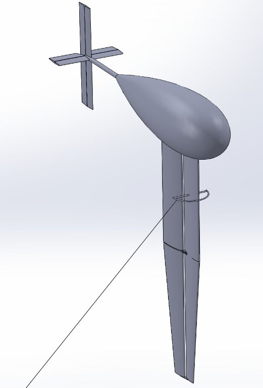

The picture below is an interpretation of the aerostat with (approximately) vertical wing. I say wing, although I would really prefer call it a sail since it performs the duty of a sail on a yacht rather than the wing on an aircraft.
I can see that you could use a bridle attached at wing tip and wing root but I think the attachments would need to be on the leading edge of the wing, otherwise tacking is not possible, at least not without two bridals. Instead of a bridal I have sketched a semicircular track with a free running traveler to which a single line is attached, the traveller taking up a position such that the tension in the line is directed to a point just forward of the center of lift (lift being a horizontal force in this case) of the whole aerostat and wing combination, thus reducing the torque needed to control the wing angle of attack. The track and any supporting structure could be streamlined so that air drag would not be much different to having a bridal. Gybing is not possible with this arrangement, nor with a bridle, but is also not necessary if tacking is possible, provided that plenty of sea room is available.
I have drawn the wing as a two element aerofoil with the front element attached to the main body of the aerostat. This wing could perhaps be quite closely based on the wing sail design used for the AC50 catamaran and the subsequent F50 catamaran since that is now proven technology and it gives a significant advantage in lift coefficient compared with a single element symmetrical section aerofoil. By having the rear element (the flap) of the wing in two sections that are individually controlled it is possible to vary the position of the centre of lift along the span of the wing (i.e. vertically) and so make small adjustments to the roll angle of the aerostat. Adjusting the roll angle will in turn give some control over altitude above the sea.
The wing would almost certainly be heavier than air, even if filled with hydrogen, whereas the body of the aerostat is lighter than air, hence the whole thing will tend to float with the wing vertical - i.e. the wing will act like a ballast keel on a yacht. Possibly that alone would be sufficient to maintain pitch stability but I have sketched a nominally horizontal tail-plane with adjustable flap(s) to help with pitch control. I have shown a somewhat larger nominally vertical tail fin with adjustable flap(s), this would control the angle of attack of the wing and hence the lift (in a horizontal direction) developed by the airborne system. I have shown the control surfaces mounted from a pole extending behind the aerostat so as to give a greater lever arm but alternatively the main body of the aerostat could be extended and the control surfaces mounted directly on it, as is done on most airships.
If the wing is to be nominally vertical then it is necessary that the airborne system has significant positive buoyancy, it cannot be neutrally buoyant since that would result in it descending to sea level as soon as the wind blows. If the design intent is that the wing is always nominally vertical then the required positive buoyancy for the airborne system can be determined by deciding a minimum angle of inclination for the tether line, say 10 degrees, and also a design maximum horizontal aerodynamic force to be developed by the airborne system and opposed by the waterborne system. The minimum net buoyancy is then that maximum horizontal force multiplied by the tangent of the inclination of the tether line. The tangent of 10 degrees is 0.18, suggesting that with a vertical wing the aerostat may need quite a lot of positive buoyancy in order to cope with strong wind conditions. Having the airborne system positively buoyant has implications for the waterborne system since the waterborne system must at all times provide a net downforce to counteract the buoyancy of the airborne system, otherwise the whole craft could become airborne and would then rise uncontrollably towards the upper atmosphere and that would be the end of it.
It is undesirable to have to reduce the buoyancy of the aerostat by releasing gas, so the aerostat needs enough buoyancy to maintain altitude in strong winds and the waterborne system then needs to be heavy enough to stay on the sea surface in a flat calm, hydrodynamic downforce from a paravane not being available in a calm conditions. However, making the waterborne system unduly heavy would incur a lot of hydrodynamic drag. One possibility might be for the waterborne system to take up sea water ballast as necessary to balance the upward force component from the tether line but that is perhaps risky since maximum ballast would be needed in a flat calm so would it be feasible to take ballast on board quickly enough in the event of a sudden lull in wind strength?
Taking the above paragraph into account, rather than having a nominally vertical wing, it may be worth considering an alternative design having wings above and below the aerostat, these wings being inclined to the horizontal plane so that the aerodynamic force developed by the airborne system is at least approximately in line with the tether line. The aerostat could then have closer to neutral buoyancy, reducing the risk that in calm conditions it might lift the waterborne system off the sea surface.
Given that with a vertical wing on the aerostat, the waterborne system does need to have a certain amount of weight, it does make sense to place as much as possible of the electrical and electronic system, batteries etc., in the waterborne system rather than the airborne system. And, as you say, a boat is probably a more economical way to carry weight than is an airship.
I haven't sketched the waterborne system but I can can envisage various options. The waterborne system could reverse direction on tacking (i.e. it could be a proa) or it could tack in a conventional manner. There could be a curved paravane, like a hook in the water, as a number of AYRS members have experimented with in the past. Hook shaped paravanes can be made inherently stable in immersion depth, at least in moderate sea conditions. Alternatively there could be an inverted Tee shaped paravane pulling downwards as well as to windward. Robert, do I recall that at one time you made one of these with a planing surface mounted ahead of it to follow wave profiles and maintain immersion depth? As a more 'high tech' alternative, I am also envisaging stereoscopic cameras, perhaps located part way up the tether line, which focus on the sea surface and clever image processing software that determines the profile of the sea surface ahead of the craft so as to make appropriate rapid adjustments to underwater control surfaces. I am assuming that we are not trying to make a pure sailing craft, so we can have control surfaces actuated by electrical/hydraulic power, probably generated by solar cells, these possibly being located on the airborne system although that does mean more weight and air drag for the tether line.
A big question is how large (and hence expensive) does this whole thing need to be? Experience has shown that airships generally need to be big to have a useful payload. In this case we are not looking to carry cargo, crew, passengers or bombs and we don't need to carry engine(s) and fuel so we do not have the problem of maintaining constant net buoyancy as fuel is depleted. On the other hand the aerostat needs to support the weight of the sail and the tether line, this is effectively the engine. So how does the weight of an F50 wing sail compare with the weight of an equivalent engine, airscrew and fuel? I did try a quick internet search but could not find the weight of an F50 wing sail, perhaps someone here knows that?

OK, you asked for a camera 50m up, the masthead on the Artemis remote controlled sailing boat is only 25m above sea level (which would still give quite a nice view I think), so you might need a small kite flying from the top of the mast. Alternatively you could scan the ocean with a whole fleet of electric remote controlled drones deployed from the Artemis remote controlled sailing boat.

That was pretty much my starting point.John Perry wrote: ↑Wed Feb 20, 2019 4:37 pmThe picture below is an interpretation of the aerostat with (approximately) vertical wing.
That is the intention.John Perry wrote: ↑Wed Feb 20, 2019 4:37 pmI can see that you could use a bridle attached at wing tip and wing root but I think the attachments would need to be on the leading edge of the wing
The airborne part always tacks. Whether the waterborne part shunts like a proa or tacks and gybes is a matter of choice. Except that the waterbourne part may not have enough momentum to tack, and may have to wear around, like a square rigger.John Perry wrote: ↑Wed Feb 20, 2019 4:37 pmGybing is not possible with this arrangement, nor with a bridle, but is also not necessary if tacking is possible, provided that plenty of sea room is available.
Research budgets being what they are, this thing has to be as simple as possible for the application I have in mind. The bridle is simpler. It is a passive system. Every actuator needs power to move, and more power still for the sensors and the processing that tell it how to move. An actuator is also another moving part that can fail. For other applications your solution may be preferable. For this one, simplicity is too important.John Perry wrote: ↑Wed Feb 20, 2019 4:37 pmBy having the rear element (the flap) of the wing in two sections that are individually controlled it is possible to vary the position of the centre of lift along the span of the wing (i.e. vertically) and so make small adjustments to the roll angle of the aerostat. Adjusting the roll angle will in turn give some control over altitude above the sea.
Where possible, I like to control attitude to a flowing medium by a surface in that medium. That way the forces to be controlled and the controlling forces stay in about the same ratio. So I think a horizontal tail-plane is advisable.John Perry wrote: ↑Wed Feb 20, 2019 4:37 pmThe wing would almost certainly be heavier than air, even if filled with hydrogen, whereas the body of the aerostat is lighter than air, hence the whole thing will tend to float with the wing vertical - i.e. the wing will act like a ballast keel on a yacht. Possibly that alone would be sufficient to maintain pitch stability but I have sketched a nominally horizontal tail-plane with adjustable flap(s) to help with pitch control.
John Perry wrote: ↑Wed Feb 20, 2019 4:37 pmIf the wing is to be nominally vertical
I was thinking that if the roll angle relative to the kite line is roughly constant, then the wing's contribution to altitude is neutral. If the wing had a constant angle relative to the vertical, then it would push down when the whole kaboodle rises above the designed altitude, and push up when the aerostat falls below.
Given that research budgets are modest, and so most weight needs to be carried by water for economic reasons, and with the wing being vertical only when the aerostat is straight downwind, I don't think too much buoyancy will be a problem. Let's say the hull carries 100kg payload in the water, and weighs another 50kg. If we want up to 10kg payload in the air, and assuming, to be on the safe side, that the aerostat and wing combined weigh four times the payload, it would need buoyancy to lift at least 50kg. That leaves a lot to be added as safety margin without risking that everything goes flying.John Perry wrote: ↑Wed Feb 20, 2019 4:37 pmHaving the airborne system positively buoyant has implications for the waterborne system since the waterborne system must at all times provide a net downforce to counteract the buoyancy of the airborne system
Just what I was thinking, except for having a wing above the aerostat. It is a complication that is not necessary if using a bridle. That is for a wing that will be vertical when directly downwind. If you were thinking of treating the aerostat like a kite, then it will pull up a lot more when parked directly downwind, and that could pull everything out of the water. The whole reason why I am not proposing a helium-filled kite like those Dave Culp experimented with is that I want the airborne part to stay at a constant altitude as it goes from one side of the flight window to the other. A kite doesn't do that, unless it is driven through the zone far from the edge of the window to develop extra power. I think Dave Culp called that dynamic sheeting. The aerostat is not intended to pull large loads, so dynamic sheeting is another complication that is to be avoided.John Perry wrote: ↑Wed Feb 20, 2019 4:37 pmTaking the above paragraph into account, rather than having a nominally vertical wing, it may be worth considering an alternative design having wings above and below the aerostat, these wings being inclined to the horizontal plane so that the aerodynamic force developed by the airborne system is at least approximately in line with the tether line. The aerostat could then have closer to neutral buoyancy, reducing the risk that in calm conditions it might lift the waterborne system off the sea surface.Yes, a proafied version of Paul Ashford's anchor dog. I attach a picture of variants of what I expect to be an improved design. I built one, but haven't tested it yet. I have to build a better connection to the canoe.John Perry wrote: ↑Wed Feb 20, 2019 4:37 pmRobert, do I recall that at one time you made one of these with a planing surface mounted ahead of it to follow wave profiles and maintain immersion depth?
Far smaller than that. Anything that can carry an F50 wingsail is far beyond the budget for the use case I am thinking of. It would be appropriate for aerostats that carry radar system for the military and for border control. Those things currently seem to need a support ship of a few thousand tons.John Perry wrote: ↑Wed Feb 20, 2019 4:37 pmTo take this further perhaps you could do with some estimate of likely dimensions. Perhaps start with an F50 wingsail
It would need to keep moving to stay upright, and I am not sure that even the best software could do that in rough seas. If it did stay upright, sending this thing through a pod of whales would rather change their normal behaviour, and then what's the point? Not suitable for the job I have in mind.John Perry wrote: ↑Wed Feb 20, 2019 4:37 pmLOOK - they have just what you want and, from what they say, it is available pretty well 'off the shelf' !
