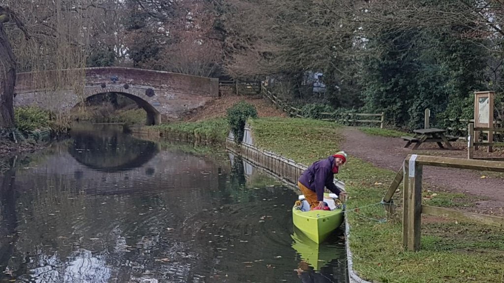

The picture below was taken on the Basingstoke canal at Winchcombe which is a few miles from the BCC but I think it gives a good idea of what this waterway is like and how attractive it is for canoeing/rowing, also for walks along the towpath. I made the green boat in the picture a couple of years ago, it is a rowing boat that can be used by one person rowing or with a second person acting as cox. There are retractable outriggers for the rowlocks, these are retracted in the picture. We will probably bring this boat to the BCC and if no one else offers a subject craft for towing tests we could use this one, although it might be interesting to have a few boats for comparison. I would say that some of us attempted to carry out towing tests on a previous occasion and we did not find it as easy as we expected, for one thing it was difficult to keep a steady towline tension. Advice welcome from anyone else who has tried this before!

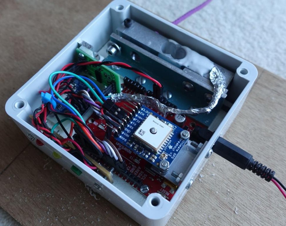

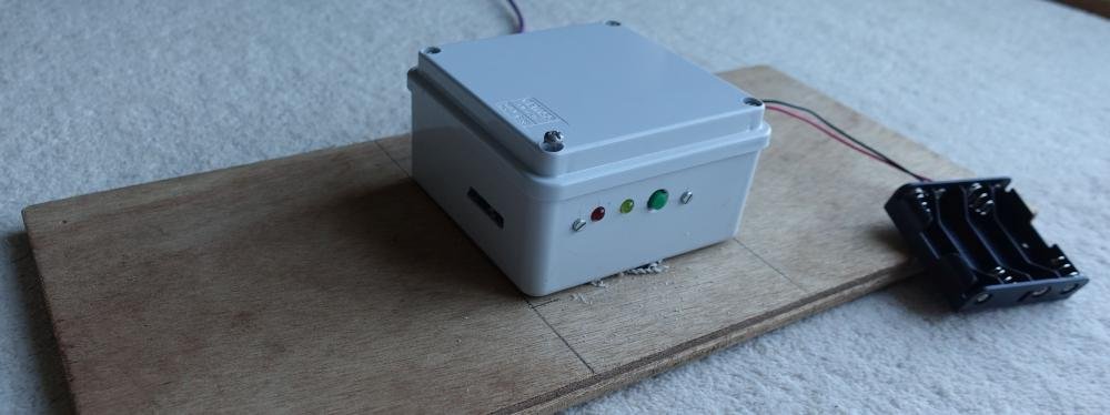

With a view to the towing trials that we might fit in on Sunday I have been playing with electronics this week. Pictures show the gadget I have made for measuring the drag and speed of a towed boat. I am not an electronics engineer, if you are one you can probably tell me how to make it a bit better!
The first picture shows that it is mounted on a piece of plywood. The idea is that this would be attached to a towed boat with clamps, lashings, or maybe just held manually. The towline to a tug would be attached to the purple string that is just showing at the top of the picture.
The second picture shows the inside of the box. I never meant it to be as complicated as it has become - at first it was just going to be a force measuring device that would send readings of the towline tension to an attached laptop computer. Then 'mission creep' crept in, bits were added so that it can operate independently of a computer storing the data on an SD card, then timing was added so that towing speed could be determined by pressing a button on passing two objects a known distance apart. Finally a gps receiver was included to give an alternative speed measurment method. There really isnt space in that small box to add much more !
