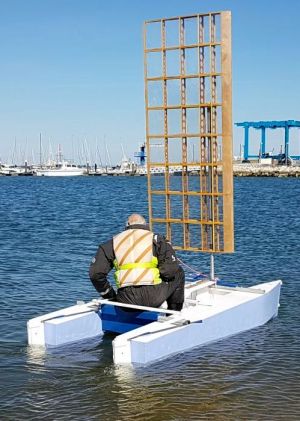

Yes, it did go ahead although with only a few people present. I went along for one day to see what was happening.
On the day I was there Fred tried for the first time a small simple wingsail that he has made. This wingsail was mounted on a very small catamaran, made by Fred a few years back. The weather was perfect for a first trial - blue sky and light breeze. The wingsail worked well, the speed being as good as one could really expect from that sail area on a boat with short waterline length and quite high displacement for its hull length. Being a symetrical single element aerofoil one could not expect a particularly high lift coefficient, possibly no better than a good cloth sail, but efficiency (i.e. lift to drag ratio) should be good, although that is of limited benefit given the relativly high drag hull platform. The sail was partially balanced so sheet loads were very light. With slack sheet the wing sail feathered to the wind and could be left unattended with no problems. Fred has made a large flat plywood box in which to store the wing sail and to transport it on a car roof rack. Storage when not in use is clearly a problem for larger wing sails. Mounting a large wingsail on a boat is also difficult - I remember the tower cranes that were needed when the AC World series race program came to Plymouth (UK) a few years back. Presumably the reason that New Zealand has moved to double skin 'cloth' mainsails rather than ridgid wings for the next Americas Cup.
Here is a picture of Fred's catamaran with wingsail - this was taken a few seconds after it was firts launched - its still in the sheltered water near the slipway. Once out into Portland harbour there was more wind and it moved along at a good clip for its size:
