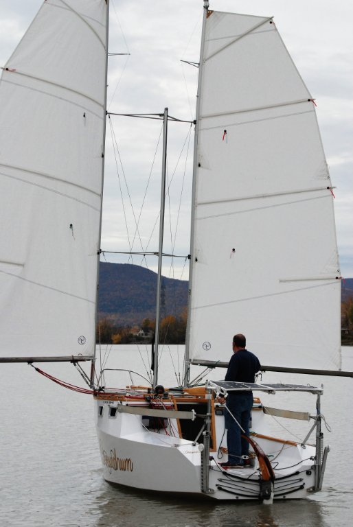

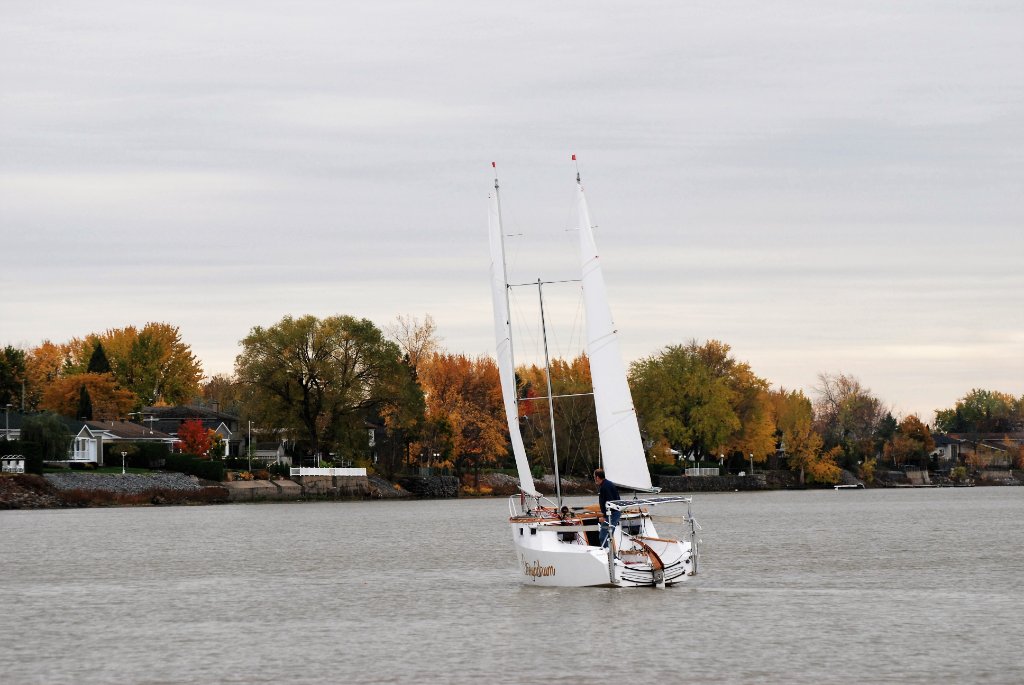

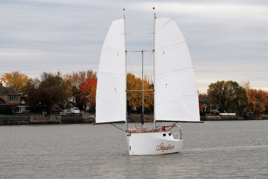

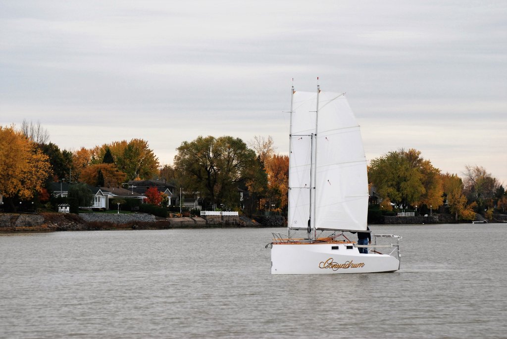

Hello
The photos seem to suggest you have built the boat itself but the rig appears to be a model, I find your project very interesting but feel that the boat ought to be sailed with a conventional rig to establish its performance before moving on to the new rig.
There are lots of novel features described in the hull which need to be proven before attempting the rig.

Re: Howard Fund
I'm glad that you find the boat interesting! Unfortunately, the rig is integrally part of the project and another type of rig can not be fixed on those hull without affecting balance, stability and efficiency . But sails performances can be demonstrated with polar curves. Also, competing with other similar units like Aviator or Sailart18 can demonstrate rig performance. I'm sure that active members of AYRS could give me relevant advice to help me in this matter. Actually, the rig is completed too; I'm now working on booms that are also quiet unusual.

Kasala latest news
Let’s say first of all that the boat is a wonder!! She is sailing really well with her roto-duplex rig! A new rig is born! With only two sails, we can reach the same speed (around 5 kn with a 10/12 kn wind), no matter the sector the wind is blowing. 30/40° beating the wind depending on how strong he is blowing! I will try soon to complete a more detailed report that could be incorporated in a future Catalyst. But in the mean time, I want to share some pictures with all you and also to thank everybody for the support you give me during those past years.

Well done getting to this stage - your boat looks good, sails appear to set well. Of course our Editor will be pleased to receive anything you can write about it! Are you planing to do more testing this year, or will it wait to Springtime now?
